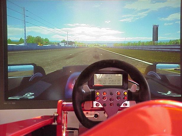

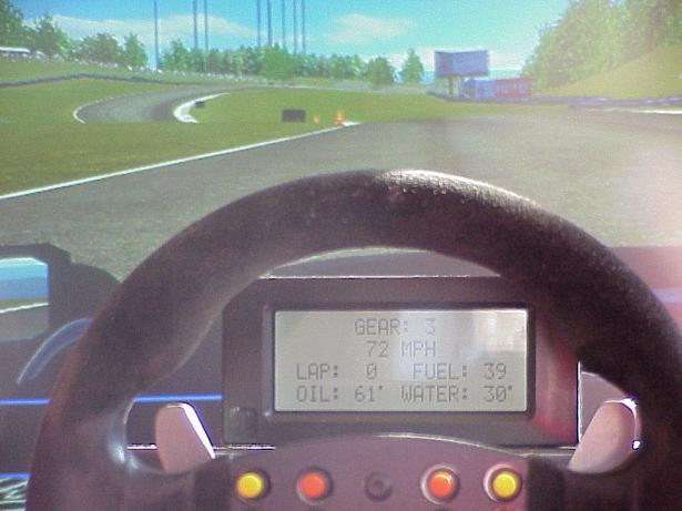

Really looking forward to the added data. In the meantime, here's some pix using the LCD.
First here's a close up of how I'm displaying the data:
attachment.php
And here's a drivers POV:
attachment.php
Absolutely loving the Crystalfontz display!! :)
