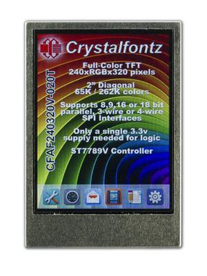

Using SPI mode at 7.8MHz on this similarly sized display:
https://www.crystalfontz.com/product/cfaf240320v020t-240x320-color-TFT
phpThumb.php
(240x320 pixel) * (16 bits/pixel) / (7800000 bits/second) = 0.16 seconds
Again, this is a lower-bounds, actual times will be slower.

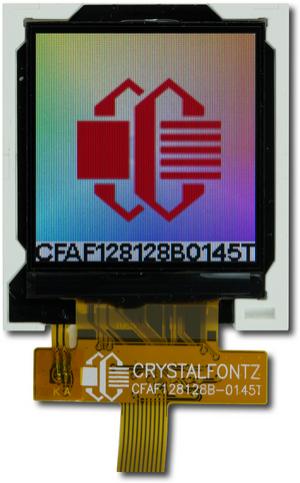

Can you go smaller? This smaller/cheaper display would update nicely over SPI:
https://www.crystalfontz.com/product/cfaf128128b0145t-graphic-tft-128x128
phpThumb.php
(128x128 pixel) * (16 bits/pixel) / (7800000 bits/second) = 0.033 seconds

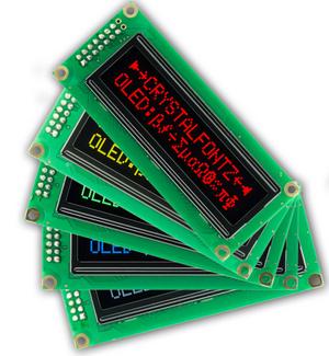

If that is all you are after, why use a TFT? Here are some nice-looking SPI OLEDs that would be an order of magnitude less complex to implement:
https://www.crystalfontz.com/product/cfal1602c-16x2-character-oled?bundle=4249
phpThumb.php

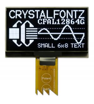

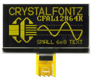

Here is a native I[SUP]2[/SUP]C graphic OLED, which would be simple to connect, and can display icons / simple graphics:
https://www.crystalfontz.com/product/cfal12864ky-128x64-small-oled-display
phpThumb.php
https://www.crystalfontz.com/product/cfal12864g024w-128x64-2-4inch-white-oled-module
phpThumb.php
Keep in mind that your project that you want to show to the investors is not a display. The display is just something you need to get done as simply and quickly as possible so you can move on to the real problem you are trying to solve.
Using a parallel, full-color TFT over an I[SUP]2[/SUP]C expander to display textual information is a huge technical problem & overkill compared to the 3 wires (plus power and ground) of a SPI OLED.
