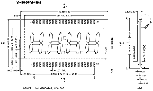

But in any case, you can get something like this:
http://search.digikey.com/scripts/DkSearch/dksus.dll?Detail?name=153-1016-ND
attachment.php
(that is just one example, they have many variants)

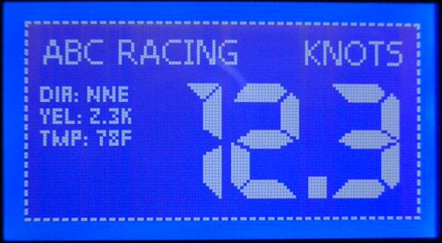

This is done with a 128x64 Graphic LCD.
attachment.php

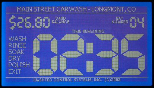

Here is another example using a 240x128 GLCD. The largest characters are about 1.3in. (33mm) tall.
attachment.php
