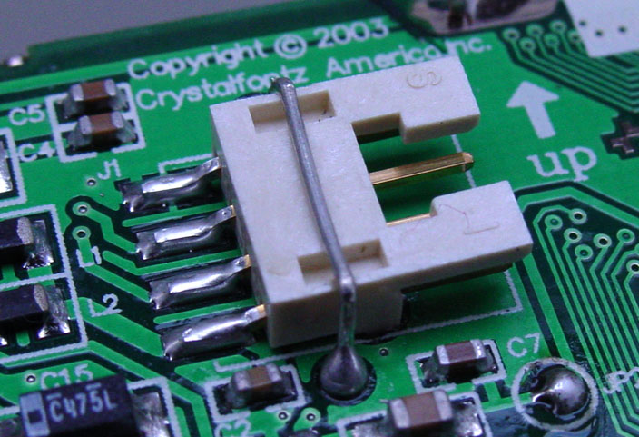

And I just bought one more... Oh well, I guess I'll be buying a new one for my old PC once the new CFA635 is out... I think I've bought at least 4 LCD modules up to now, 2 631's and 2 635's. The first 631 was destroyed by the (IMHO) bad design of the USB connector*. I guess the 2 635's will just have to live out their backlight hours...
* The USB connector is designed so that the cable is inserted parallel to the board. So when the cable is pulled too fast (by accident), it rips off the connector from the board. A better design is that of the SCAB connector, where if the cable is pulled too fast, the worst that can happen is that the cable is pulled of and maybe some plastic is bent. Maybe I should put that complain in another thread though...

We have the USB connector on the CFA-631 fixed now:
attachment.php
Also . . please check your private messages :)
