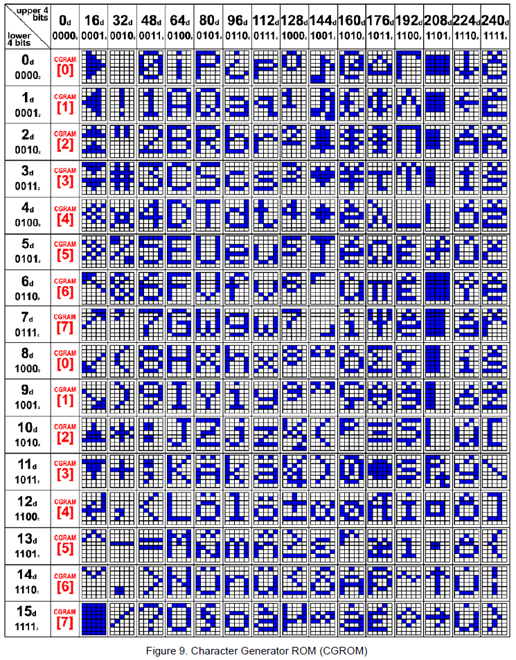

The CFA-635 can only allow the 8 CGRAM characters to be arbitrarily programmed, and show any of the characters from its CGROM:
attachment.php

Yes, I understand. But I was wondering if it were possible to improve the LCD firmware where it would decode the actual extended ASCII symbols automatically.
Currently, if you were to directly send '[' (91d in ASCII table) to the LCD, it would display 'Ä' (91d in the CGRAM table). Which is quite odd and which is why for these characters you would have to manually pull apart character-by-character and check if you need to manually send it to the display. I think my question was not clear. But this is what I am hoping to get answer for.
