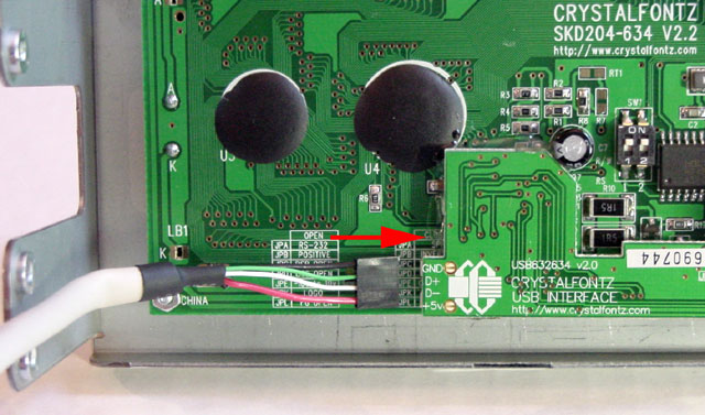

But there is one thing I can't seem to get straight. I'm intrested in the USB LCDs, primarily the 634-ones. But when I look at this page,
http://www.crystalfontz.com/products/634usb/index.html
the backside of the LCD holds a serial port. Shouldn't it be a USB-dito? The cable that ships with the package is it supposed to connect this serial port with an USB header port on the mother board?
CF Tech
Administrator
The WRUSBY03 or WRUSBY11 plugs into the back side of the USB daughter board, just under the logo.
The DB-9 (serial) connector is disabled and unused on a USB module.

I see!
What is the difference between the units showed below "USB LCDs" and "Character LCDs"?
Are the latter ones not prepared for USB-connection? I really fancy the orange one, which doesn't seem to be available in 20x4 format... :(

Hey it´s my first Time to be her,
I have just buyed a 634 Display whit Serial, is it posible to make it to a USB Display ?
Thanks
CF Tech
Administrator
Yes, it can be converted, but you would have to return it to the factory.
Alternatively, you could use a USB to RS-232 converter cable.
