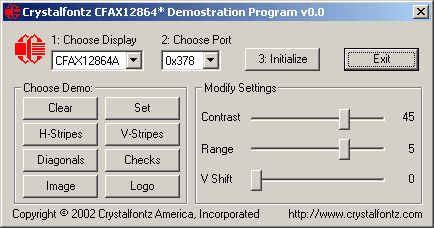

That software is a simple in-house utility:
attachment.php

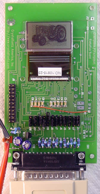

that talks to a simple evaluation pcb:
attachment.php
Here are the files:
Schematic
VC++ 6.0 Source and Executable
For W9x, just unzip it in a directory and execute it.
You will need to install port95nt if you want to run it under 2K or NT.

When I try to run CFAX_WinTest.exe I receive an error message:
File MFC42D.DLL is missing.
Where I can that file?
Sorry about that. I have updated the executable zip file linked above to include those DLLs:). Now it is much bigger:(
The PCB with all components assembled and tested is $200 (plus the cost of whatever display you want connected to it.
The PCB is not perfect, there are two components on the back and one jumper on the front. Also, the EL works, but interferes with the operation of the display. We are pretty sure this is a layout problem, since a EL demo PCB from Sipex works fine in the same location. Therefore the EL section of the PCB should be considered not functional.
Back
Top
