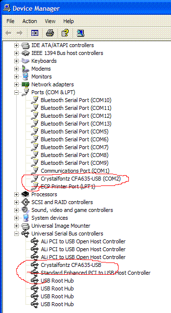

Does it show up in device manager? There should be two places in device manager:
Slashweep
New member
Yep, screenshot of device manager of my desktop pc with the 635 plugged in to my pc.

Hmmmm.

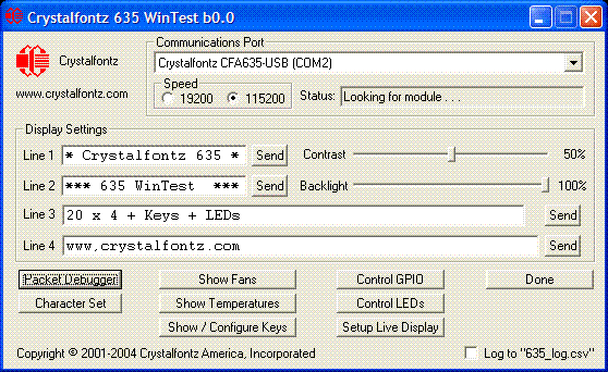

Does COM2 show up in the list of ports for 635_WinTest?
The baud should be 115,200
After that . . . I don't know. I guess I'll have to get support to get a ticket going for you.
Slashweep
New member
I double checked my com settings from some of the linux guy posts. I get the same type "error / not working" on both my desktop and laptop. I attached a photo of the 635 tester app.
