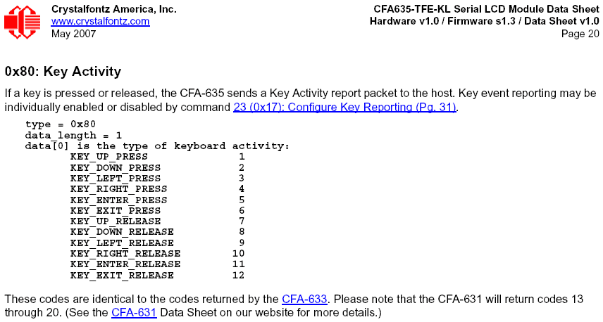

The module should return a packet as documented in the data sheet.
A key report will return as follows:
There should be the 0x80, the length of 0x01, then one of the 12 key codes, then the two bytes of CRC. Each key transition should result in two packets being returned, one with a "press" code, and one with a "release" code.
Ideally, your code should parse the packets and verify the CRC, but checking for a 0x80, and the 0x01 followed by a byte between 1 and 12 should get you pretty close.
