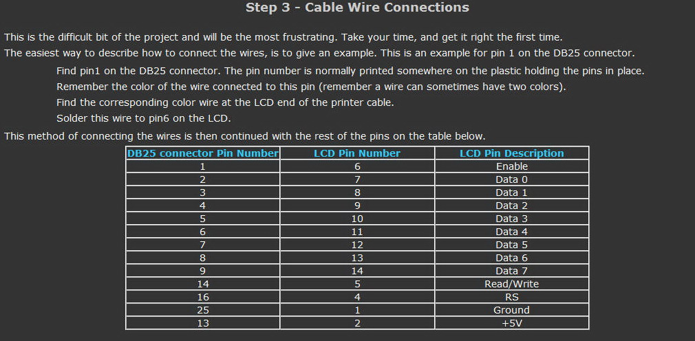

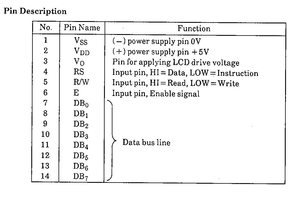

maybe u guys can tell me if i connect this lcd to PC using the LPT connector (PC's parallel port),i mean if my lcd is compatibile HD44780 and if i can use it with CrystalControl2 i'll be grateful

You should be okay as long as you know the pin out of the module you are working with and the controller is HD44780 compatible.
