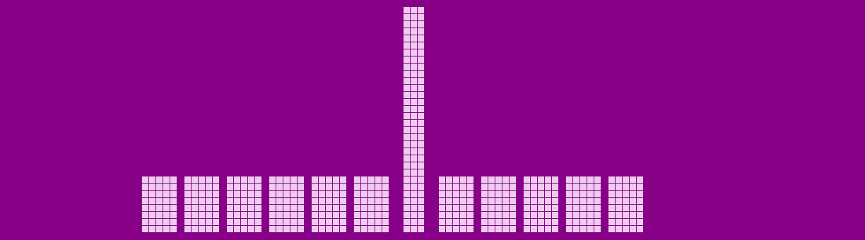

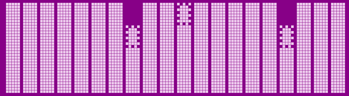

Big update to LCDControl. By making use of xmms2 and libvisual, LCDControl produced the following. (Sorry, no music)
PCM - This is my favorite
attachment.php
Peak
attachment.php
Spectrum
attachment.php

I just finished much of the graphic display support. Here's a demo of what can be done.
It's a little slow transitioning right now because of copying buffers. libvisual has some assembly code for this very purpose that I'll probably borrow. There may be other options that'll speed it up as well. We'll see.
