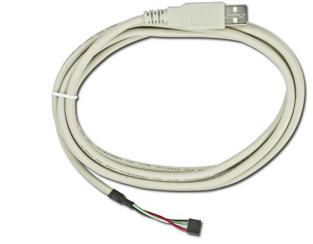

Hi all. Long time CrystalFontz user. I have both a CFA633 and a CFA634. I would like to use the CFA633 in my Raspberry Pi 3 Model B. The CFA633 came with a USB cable; the part that would normally mate with the computer is meant to be plugged into a motherboard header. It's got four pins, a +5V, +D, -D, and GND.
I'm really a newbie when it comes to this. It's just a hobby and I'm hoping I can use two of the GPIOs on the Pi to play with the screen. I haven't tried to do it yet, but am hoping I can get some help before I try and/or possibly blow something up.
Thanks!
The easiest way would be to just get a WRUSBY03:
That should get you going without any fuss :)
It's a cheap cable, yes, but the nerd from within is wondering if it's possible to use the GPIO's--are there technical limitations? I really want to dabble and learn hands on, but if it really can't be done, then I'd like to know ahead of time. :)
Thanks for the info.
